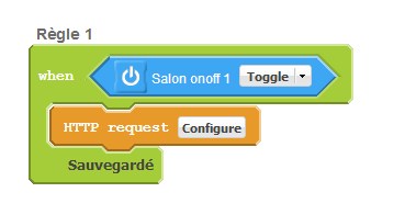

I made my first rule:
When CONTROL on SWITCH ON/OFF (fgs211) TOGGLE
HTTP REQUEST to pushingbox
Then I switch ON/OFF on the dashboard or by the way of the thermostat and I never receive any mails.
I tested the URL of the pushin box and it works fine (I received the mail)
I did the same with the action SEND MAIL and I never receive the mail.
May be I did it wrong, in this case tell me why please? at least could you have a look please?
In attachment the rule

From the attached image I don't see your HTTP request configuration.

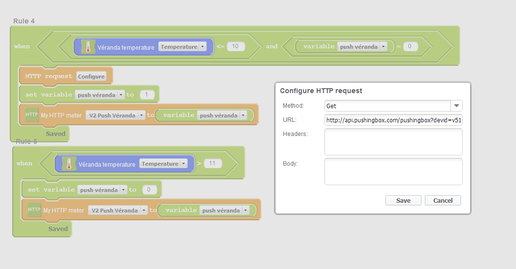

try to put "On" or "Off" in when condition.
The rule start when an event comes, and you can check this in Event Widget.
I use HTTP for PushingBox and Email without problems.

Nice rules ChrisDalo and thank you for your example.

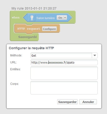

I confirm that the request was sent three time, I set the request to an Apache server that I own, this is the access.log:
85.171.xxx.xxx - - [31/Jan/2013:21:25:13 +0100] "GET /zipato HTTP/1.1" 403 - "-" "Java/1.6.0_32"
The IP is my IP. So the request is sent by my zipabox.In attachment my rule

This test was performed with a FGD211 (dimmer) : when turn ON

So, the problem is that the rule is sending three requests?
What was response code from your server? From your log I'm thinking it's 403 (Forbidden). Try putting some url that will return status code 200 (OK). Then please post the result.

Yes the box is sending 3 requests
I did it with a status code 200 (OK): same result.
85.171.xxx.xxx - - [31/Jan/2013:22:20:01 +0100] "GET /fr/index.html HTTP/1.1" 200 23219 "-" "Java/1.6.0_32"
85.171.xxx.xxx - - [31/Jan/2013:22:20:02 +0100] "GET /fr/index.html HTTP/1.1" 200 23219 "-" "Java/1.6.0_32"
