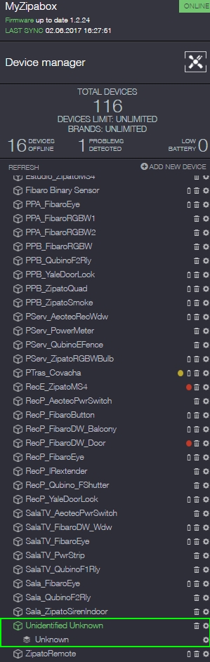

Do any of you has seen this before on your device manager?? I don't know at which point I got this, I noticed one time looking for an attribute for a message an "unknown" device and then start looking for this, noticed this on my device manager z-wave three, I wonder what happened here, all my known devices look good so far.

No, I havent seen this for a long time and when I did, it was an unsupported device. So no idea. What you can do is to open the root device, go to advanced and click on configure node. This will revert back the device to factory settings but at least will give you idea what the device might be as it gets renamed on root level only.
Thanks for the advice Attila, I tried what you mention but the device stayed the same, all my known devices are there so I will delete the module. I dont know if this was produced while attempting to reinclude a device that wasn't taking any parameter changes for some reason, after the re-inclusion it works fine but I had to try couple times to re-include, I had 2 failed attempts.
