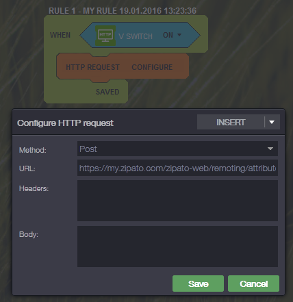

However it is possible to set a value of a Virtual sensor from a Rule by using an http request puzzle as in the attached pic.
