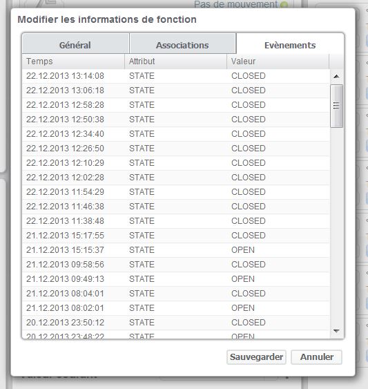

My Fibaro Universal Sensor FGBS321 report their state CLOSED every 8 minutes (not that there was any change) ( It's the same PB on Four Device)

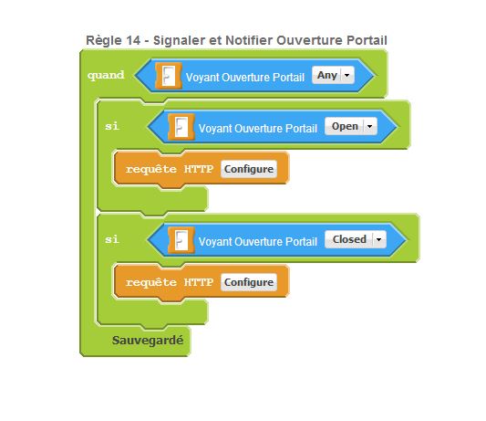

As I have rules that send me notifications eg: open / closed, since this morning I receive all 8 minutes a notification Closed Closed Closed ....
On the copy screen we can see the transitions Open / Close the 21/12.
since upgrading this morning ........ it is wrong.

I checked the fibaro door sensor events and CLOSED state appears every hour.
