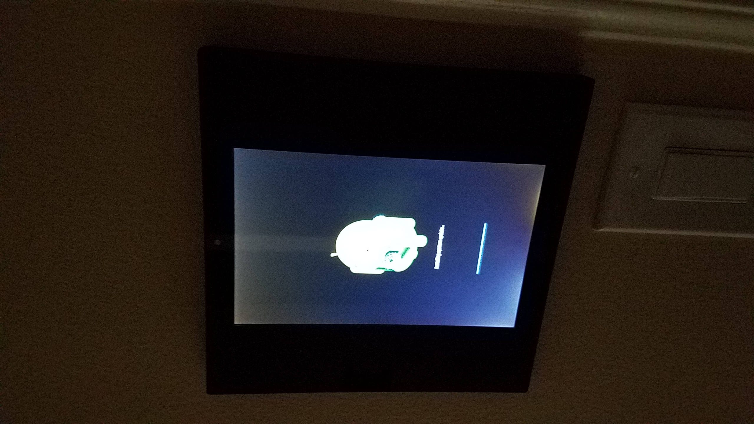

Mine is upgrading now...
[EDIT] Upgrade complete, feels more responsive (less lag). Nothing negative so far...

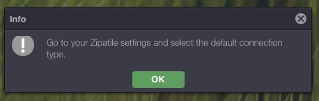

Since the OTA upgrade of the Zipatile I get this message after login to Web Controller everytime.

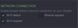

And I found this settings:
Does anyone know what this could mean or what settings does what?

Hi, I dont have this today but I have seed the same warning message on Monday as in your 1st picture. This is definitely some control system they are currently implementing. I just hope that they will fully finalize before implementing, not like the battery alarm or the virtual thermostat humidity and ventilation or the backup that they still struggling with.

Hi all,
here's the short explanation about the Zipatile Network Connection.
https://community.zipato.com/knowledge-base/article/zipatile-network-connection

If got a ver clear message and after setting up accordingly all is fine and no message appears again.
