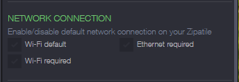

Zipatile- Network Connection
Zipatile Network Connection explanation:
- please update your network configuration for internet connectivity usage
- Wi-Fi default: check this box if you have internet connection via WiFi
- Wi-Fi required: check this box to prevent loosing the WiFi network when ZipaTile enters Sleep mode
- Ethernet required: check this box if you have Ethernet connection
