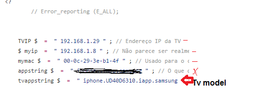

For those of you having a Samsung model 2011 or newer (with network connection of course), this PHP script works really well for controlling the TV:
https://github.com/avtehnik/samsung-smart-tv-php-udp-control/blob/master/samsungremote.php
Place it on your webserver (Synology NAS in my case), and call it with URLs like this:
http://myserver/samsungremote.php?key=POWEROFF
http://myserver/samsungremote.php?key=VOLUP
I'm not sure what to use it for yet, but I read about a guy who managed to get his front door camera show up in picture-in-picture when movement was detected.
the POWERON command does not work, because the TVs nic goes to sleep while the TV is shut off. Someone mentioned that it was possible to work-around this by connection a power switch to the TV. When power becomes available, the TV nic is (supposedly) listening to network traffic for 30 seconds, making POWERON possible.

Unfortunately, no. The TV interface does not speak http, it is a socket stream connection to port 55000.
After opening a stream to the TV, the script writes this to the stream to POWEROFF:
iphone..iapp.samsungHdMTkyLjE2OC4xLjE1MDAtMTEtMzItMTEtZGYtNTI=cGhwIFNhbXN1bmcgUmVtb3Rliphone..iapp.samsung�iphone.UE40D6325.iapp.samsungS0VZX1BPV0VST0ZG
The iApp and iphone references are there because the script imitates the output of the Samsung iphone remote app. The actual command is base64 encoded.
