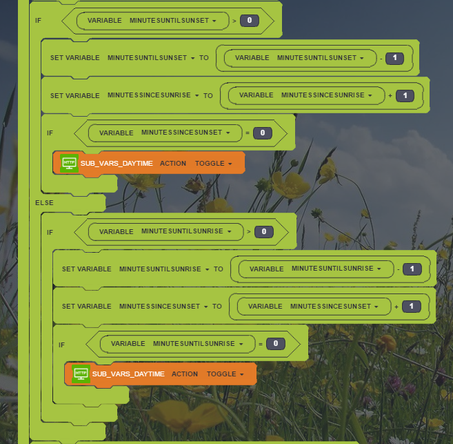

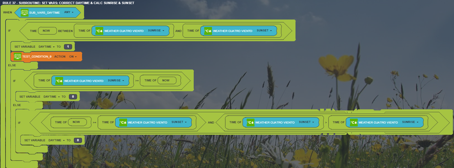

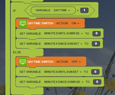

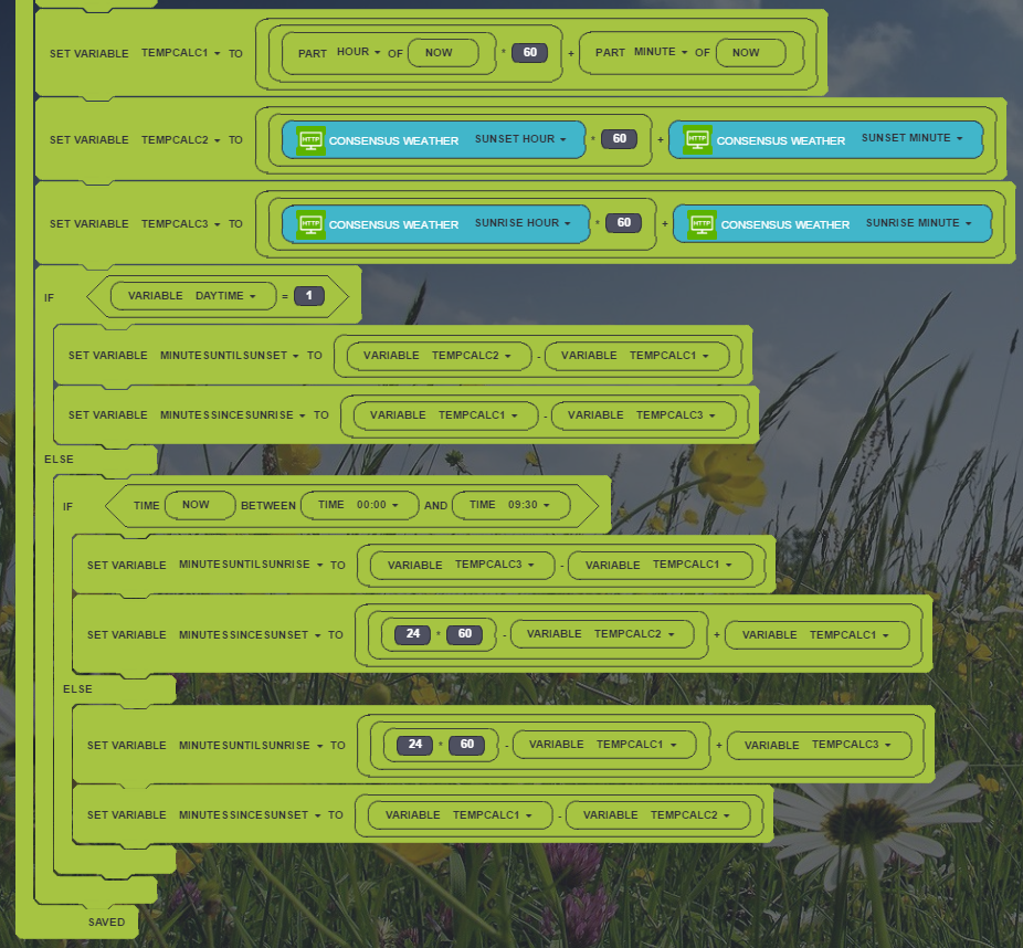

Actually I use a different method right now. Rather than relying on a one-time only change of switch state (which is vulnerable to restarts or disconnections), I run rules every ten minutes to recalculate everything. First I work out whether it's daytime or not by looking at the sunrise/sunset values. Then I initialise four variables: MinutesUntilSunrise, MinutesSinceSunrise, MinutesUntilSunset, MinutesSinceSunset. Then I calculate those values using the sunrise/sunset times, and finally increment them in a rule that runs every minute. The first three parts run every ten minutes, so the system quickly recovers if the values are lost due to a reboot or whatever.
The third screenshot shows sunrise/sunset values imported from an external source (via a Google App Script), but actually I think you could use the Zipabox values just as easily.
