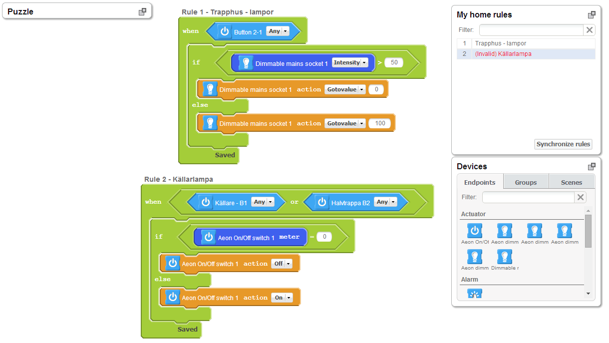

1. Is there a way to read the Aeon Smart Switch to see what state it is in, just like the Aeon Illuminator can be read for what intensity it is set at? The rules creator says "rule2java:null" when I try to read if the Aeon Switch is on or off.

As you can see, Rule 1 works great, but Rule 2 will not compile.
/Bo
I think there's a bug with the eaon switch devices. Because it doesn't look right.

I want to control the Aeon Switch from two (or more) different wall switches.
The Aeon Switch is a simple on/off, so there is no intensity variable. Also, it is a bit confusing that it says "meter", since it does not have the capabilities of energy metering. It should be a simple ON/OFF, or 1/0.

So if switch B1 or B2 are on then turn on the Aeon labs? and when off turn off the Aeon labs?
Try this:
When switch B1 = On or B2 = On
If Aeon Labs=Off (use sensor)
Turn Aeon Labs On
New rule
When switch B1 = Off or B2 = Off
If Aeon Labs=On (use sensor)
Turn Aeon Labs Off
Yes! You nailed it. The trick is to use the Aeon Switch as a sensor, and not a meter.
