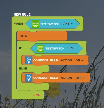

Find attached and example of how you can turn ON/OFF a Phillips Hue Bulb using a virtual switch.
Daniel,
I guess I don't understand what do you mean by "binding". Can you show me the rule of how are you trying to control your phillips hue bulb please?

I tried your solution through a rule, this does not work either. Strange enough, the lamps all marked as offline... even after deleting and adding them again.
Alberto
Daniel,
Ok I see what you mean. Native Binding or Direct Association only work between two or more Z-wave devices, what this function does is creating a "direct link" between two groups of the devices. This is used so there is no dependancy of the Zipato Controler. For example, you can create a direct association (or native binding) between a Zipato Keyfob Red Button 1 and a Qubino F-Shutter, once you create this association using the zipato controller, you could even power off the controller and the Flush Shutter would still react to the Keyfob Red Button 1. This does not work with virtual devices, these "live" on the controller and they are linked to zipato servers, so, no controller, no virtual device.
Now, if you have created the rule, saved and synced succesfully it should work. If your lights are shown as offline then the problem is with your hue bridge and/or internet connection. I don't want to leave the obvious aside and make sure your lights are powered, then make sure you can control them using your hue app on your phone while connected to your wifi network, then see if you can do the same using your mobile data (remote connection), if all that works and the lights are still shown as offline then open a ticket on zipato support, looks like there is a problem with your controller. If you couldn't control the light in any of the previous steps then the issue is in your router or internet connection.

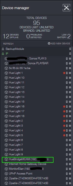

Another thing to check, see the IP on the attached picture, usually when you add your hue brigde to zipato it is recorded on the name, verify that the IP shown in the name is the same as the one in your bridge (you can see the IP on the hue app).
Daniel,
