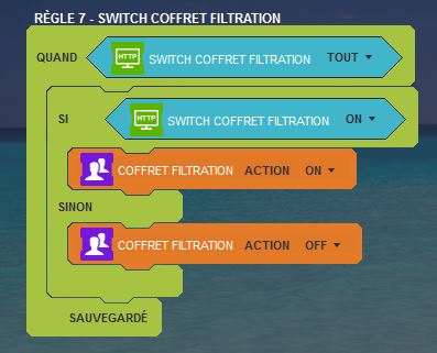

Then a rule similar to this:
WHEN virtual switch ANY
IF virtual switch ON
RUN science 1
ELSE
RUN scene 2
SAVE
You could do this creating a group of lights, but I haven't used this feature yet, so not sure how it works.

The rule works fine but, when the rule toggles the virtual switch, it changes of state without the parameter changing state.
Since the last action on the switch by myself no log was recorded whereas the rule act on the switch. Furthermore, whatever the true state of the switch, it is marked as off in the dashboard.
It's a real mystery.
To try something else, in addition of the action on the switch, I add in the rule a changing of state by the action of a "SET SELECT TO" but none result.
It's incomprehensible.
