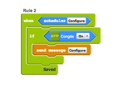

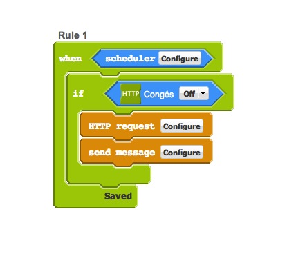

I created a virtual switch which I test (on or off) in 2 different rules and it is not working because whatever the status I receive the 2 mails from the 2 rules (see image attached)
What am I doing wrong?

Try to put virtual switch in sensor puzzle and use True (on), False (off).
Thanks,
It worked using the sensor puzzle and putting the "actuator" (not the control) piece
