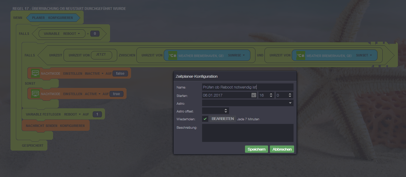

I think, value changes are not detected by the when rule. So you have to use another way. One way is to use a scheduler (Planer) and check regularly (e.g. every five minutes) the state. I do something similar with my reboot check (which I use to reset the virtual meter to the right state) (attached picture)
