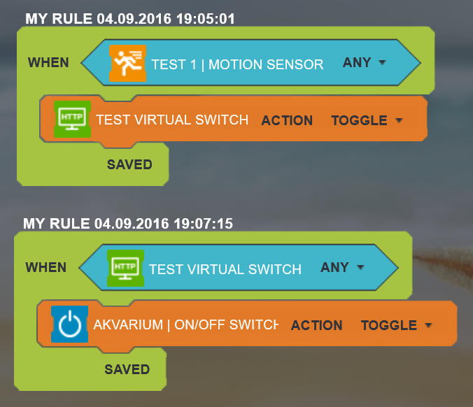

I have created a very simple demo of this. If you have sensors and switches you can test this on your own Zipabox: Create the simple rules, sync, disconnect the ethernet connection from your zipabox and you will see that the rules still run.
Brgds
Robert

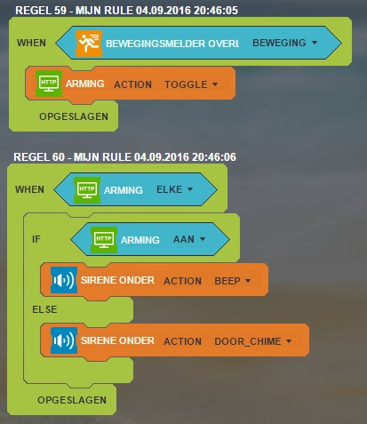

Robert,
I tried your test, see attachment, and while online, it works ok. When I disconnect the internet than I hear only a sound the first time the sensor is triggered, after that only silence. When I reconnect the internet then, after the connection is established, I hear the sounds again.
There is one strange thing tough, when I disconnect the internet, the green light starts flashing, so far normal. After I did the test I reconnected the internet and the green light was still flashing. After a short period, the green flashing switched to a blue flashing and after, I don't know, I guess 30 sec. the green light came on again. Only after the green light was on again did the rule work ok again.
So any idea why my zipabox switched to a blue flashing light? If I'm not mistaken this means that JAVA is loading???
I am on firmware 1.0.19
Frank.
Frank,
It sounds like your Zipabox crashed and restarted.
There's something strange going on in your Zipabox, because this set of rules definitely work fine without an internet connection.
