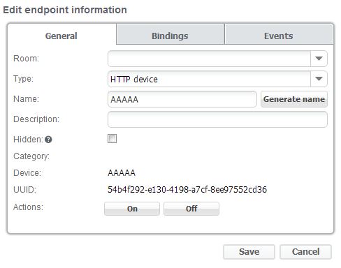

I just created a Virtual SWITCH but don't see URL at all, only an ON/OFF buttin (see attached)

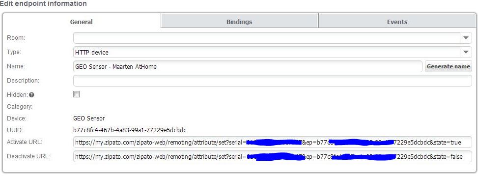

What also happens (not always) is that if you create a Virtual Meter or Sensor (yes i do have http here) that after a reset or refresh of the control center the API suddenly dissapears. I have several meters that i used with IFTTT and XBMC where i copied those URL's in the configuration, but after sometime they stopped working and it seams that the API key is gone in the Control Center of these devices.
