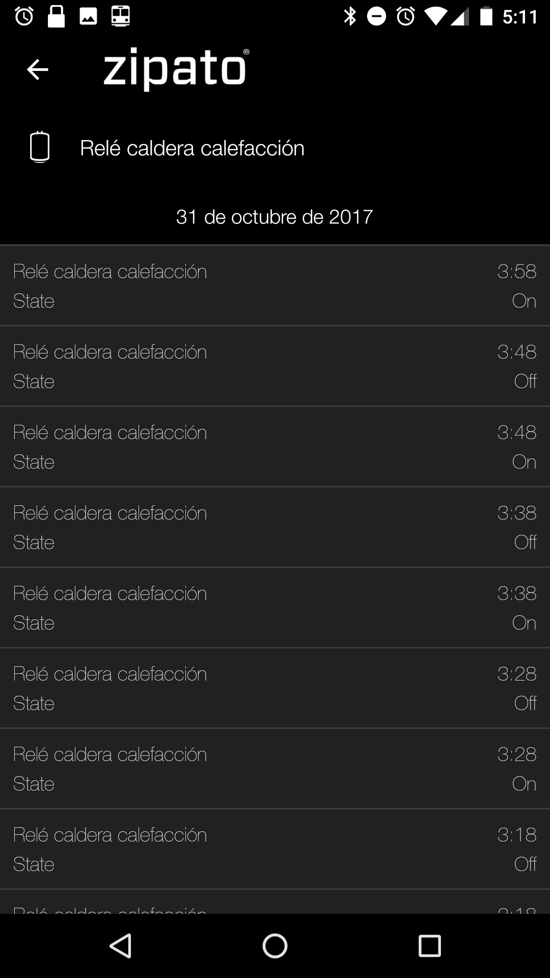

My Zipatile relay is connecting and disconnecting the boiler, supposedly according my 4 virtual thermostats Pro schedules (multiroom config).
But the problem is the relay is not responding or the virtual thermostats not working, because when I have a temperature difference between set point and current temperature, valves open but relay doesn't act.
After several hours with 2-3 degrees of difference and the house cold, I reset the Tile and finally it works. But only few minutes or even less than a minute!! Then again no relay action or nonsense action. See the attachment with the ON->OFF in the same minute.
