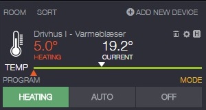

It is in any way possible, to get the Virtual Thermostat under 5 degrees????
Use the "virtual Thermostat" in a greenhouse, where I want to be able to control it around 0 degrees.
Hope there are some that will help me, please :-)
