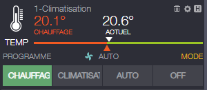

Well, nothing changed. I can see still the following:
As you can see there are only three tabs to be selected, and selecting and synchronizing with Zipatile2 I see still both setpoints on my controller screen.1012fad1f9620e48d82c8a77057d226a
