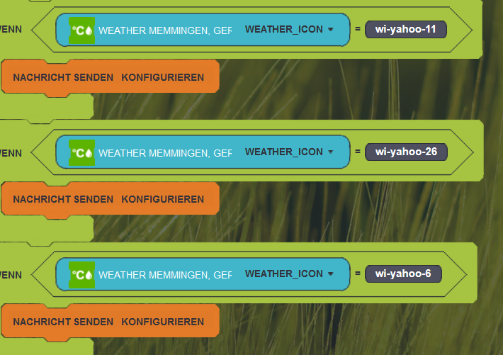

i got it i have to set string as wi-yahoo-## and ## is the number

Is it possible in this way? I don't received a test notification yet

Also in case of definition time between sunrise and sunset. Is it possible to do it in this way with virtual weather station? I also didn't received a notification yet.

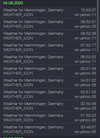

if you check event logs for WEATHER_ICON attribute, you can see its values - see fir. If you set those vlaues in the rule creator, it shoudl work.
ICON attribute is not used by Yahoo - there is no event in logs.

it means i have to set e.g "wi-cloudy" as string into the rule?
