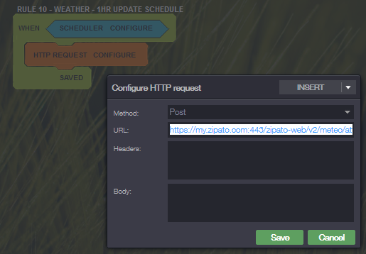

I have created a simple rule (that is now disabled as my weather updates regularly) with hourly recurrence that asks on API level to refresh the weather station. Tested and it works.
the HTTPS call is:
https://my.zipato.com:443/zipato-web/v2/meteo/attributes/values?update=true
