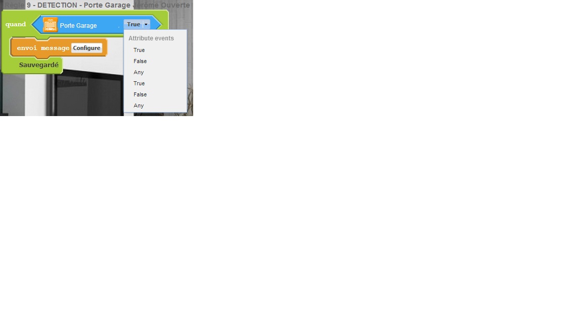

I configured two ZG8101 on my Zipabox. No problem with setup it on the Zipabox.
My problem is when I created a rule : when the sensor state is True (door open) the system must send me un message (email).
I use this rule with another sensor without problem, but with the sensor ZG8101 nothing happen.
When I read the eventlog, the sensor is True when the door is open and false when the door is close.
Have you an idea how I can setup this rule or this sensor ?
Thank you
Why I can selected many states about my sensor ZG8101 (watch screenshot) : 2 True value, 2 False value....
I can choose any value in my rule, nothing happen.
Have you an idea ?
Have you an idea ?

News about the device. Until the last update, the state of the sensor taken into the box.
I can configure rules and actions according the state of sensor
