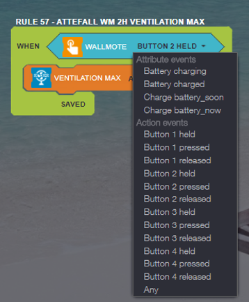

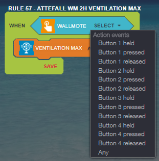

Actually a few events actually dissapeared when I did this. See images.

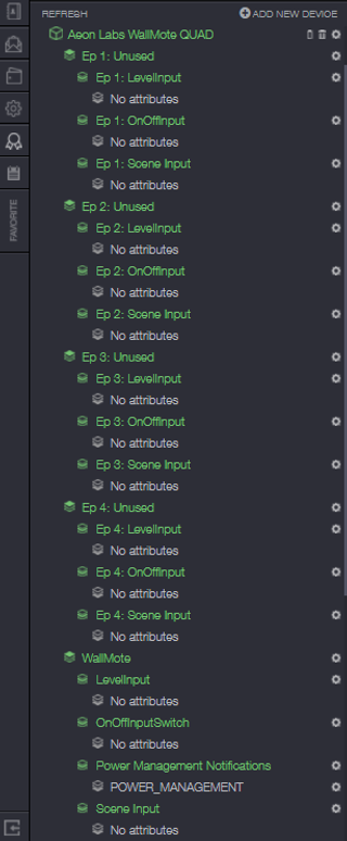

-Wallmote Devicemanager Tree: The whole tree of info from my devicemanager.
-Wallmote Events BEFORE: The events to choose from before rejoining the device.

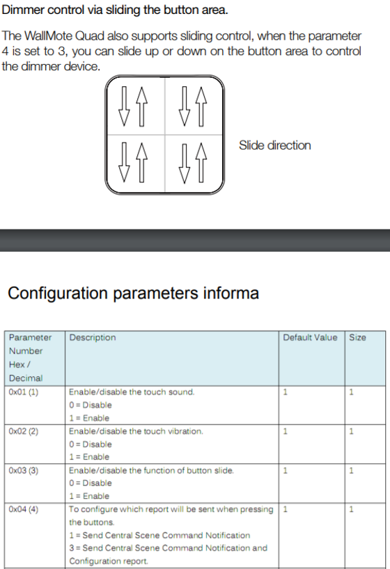

-Wallmote Manual parameters: The info from the manual about sliding functions.

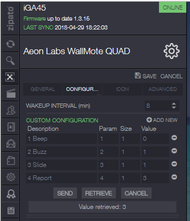

-Wallmote Custom Config: The configuration I did manually.
-Wallmote Events AFTER: The events to choose from AFTER rejoining the device.

One more very interesting thing is that the Wallmote manual actually says: Swiping up once will dim up a dimmer device by a certain percentage, while swiping down once will dim down a dimmer device by a certain percentage.
If this is the case then the functions StartchangeUp and STartchangeDown etc must be wrong????

I think you need to use manage association in the advaced tab to use the swipe/dimmer function of the wallmote. As it's described in the manual as group association.
I don't have any luck to associate anything directly to each other with this function. Maybe it could have to do with the secure inclusion of all of my devices. I read something that it could cause some issues.
Thanks Alex. You are right. This comes down to group associations. Probably exactly as stated in the Wallmote manual.
I had this reply from Aeotec in my ticket with them:
Swipe up and Swipe down are "Group Association" only for direct control or direct dimming. It cannot be used for scene control. (Group Association #3, 5, 7, and 9 for dimming).
​Scene control is only used for Tap, or Press and Hold in this case.
Swipe Up or down will send MULTILEVEL SWITCH LEVEL CHANGE and a second later MULTILEVEL SWITCH LEVEL STOP which does a slight change in dimming for direct control of devices.
