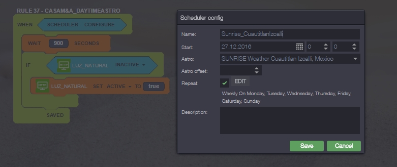

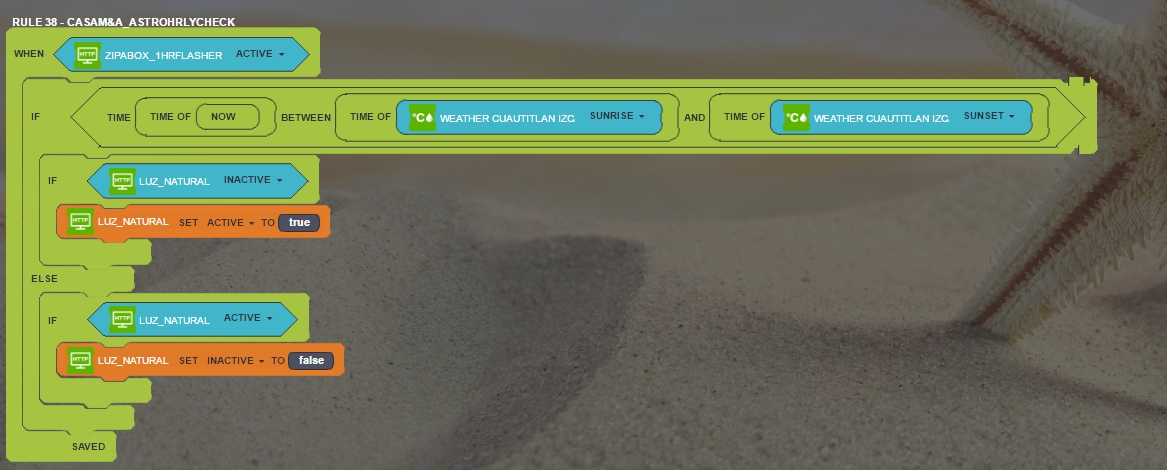

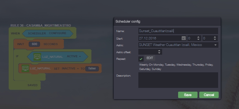

Short answer, there are basically two ways of doing this (using Zipato resources only, or you can ask David how to create VERY reliable and complex weather updates).
1. Short way is by using comparison IF TIME OF NOW BETWEEN TIME OF SUNRISE AND SUNSET THEN whatever on each rule you want to use it.
2. Using a few rules you turn ON/OFF a virtual sensor/switch based on DAYTIME/NIGHTIME using schedulers with astro function, and then use this sensor/switch in the rules you want.
My case is second. See attached, third rule is an hourly check I perform "just in case" and I also do the same when the zipabox restarts.
