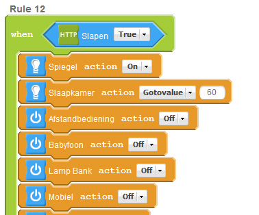

I'm want to use it in the attached rule...
I want to make the following rule:
When slapen is true
Turn on Spiegel
Slaapkamer goto 60
etc
When Slaapkamer = 0 then turn off spiegel
etc
You can do that only if your dimmer is fully supported by Zipato.
Rule should look like this:
Oke, i'm using a Duwi Dimmer (plugin type) and it's not working like above. So there's no full support :(
