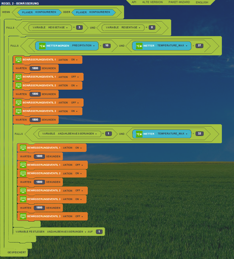

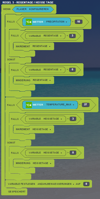

I also try to play around with such rules.
But I have a different approach to this as I don´t want that irrigation is running, when it do not really have to. (saving water)
For my purpose I use 2 different rules. One check the weather situation and the other one the irrigation in dependence of time and the weather situation.
I could not test it by now because my irrigation system is not completed by now but I think it could work like this.
Have a look at my approach and maybe give me feedback if that could be a cool system or if you see any problems.
