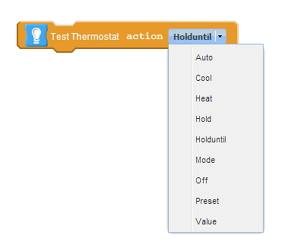

In the rule creator, we can select actions on a thermostat. Where could we find the explanation of the various actions available:
* Auto - I guess this is to put the thermostat in 'automatic' mode
* Heat, Cool, Hold, Holduntil, off - there are the same actions as the buttons we have in the thermostat itself (but we cannot specify any value for these actions in the rule creator, except for the 'heat' action)
* Mode - no idea how to use it ?
* Preset - no idea how to use it ?
* Value - no idea how to use it ?

* Mode - auto, heat and off
* Preset - You have set some values for the day, night, away, or confort, so you can call them
* Value - Its the value of the temperaturetu you want to have
