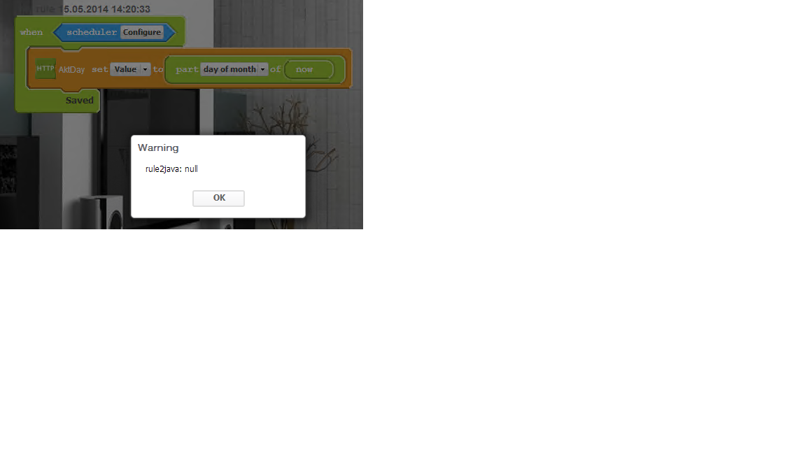

Why do I get Warning rule2java: null when i try to save my rule?
Mikael Åberg shared this problem 12 years ago

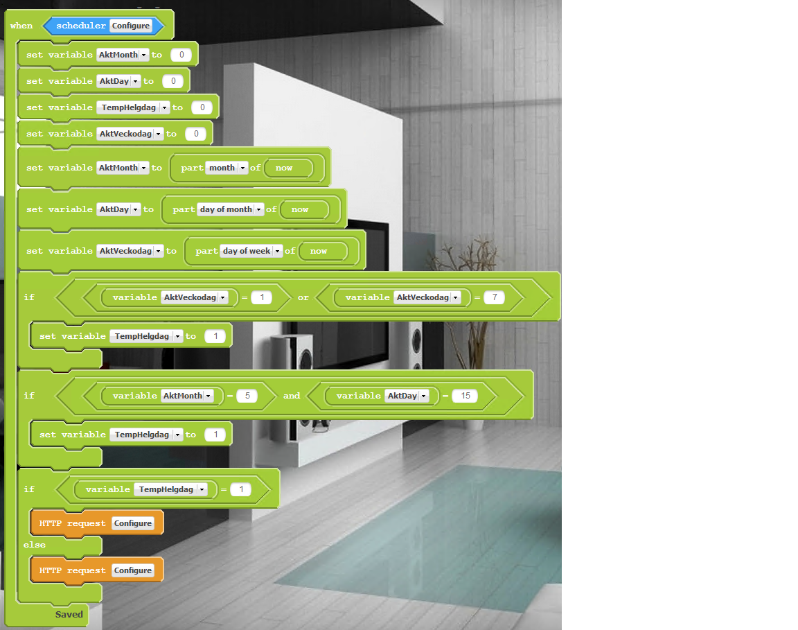

I do not have any variables that does not have a start value etc in my rule.
When I look at the blocks it is all correct.

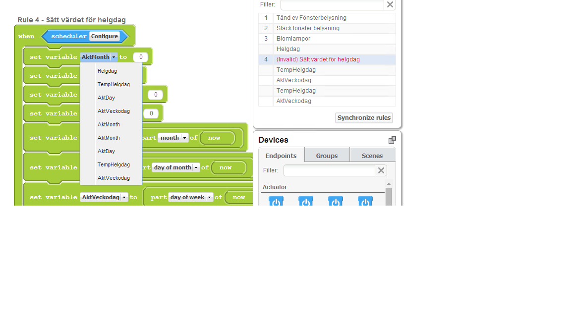

Found another problem.
I can select variables (some is in the list double), but in the list of variables on the rule they exist only once.
I have found the problem, but I can not fixe it!
If I use the function "Day of Month" it gets this problem, there is some problem with this function.
