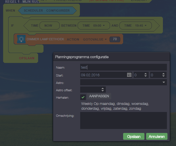

I'm only just starting to work with the rule creator, but it already gives me a headache. I want to create a rule to set my dimmer to a certain level in a specified timeframe, but it just doesn't work...
Yes, I did save the rule and I did synchronize with the box.

your rule says:
1 - At 0:00 (midnight)
2 - if it is between 9:00 and 19:45
3 - then put the light at 70
well... midnight is not between 9:00 and 19:45 so it will never work.

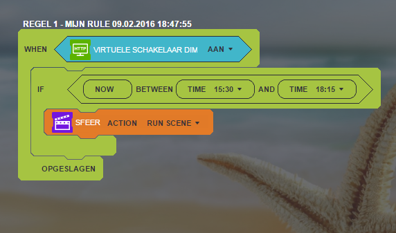

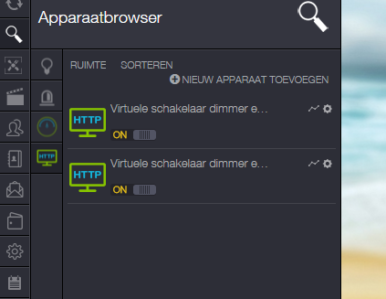

OK, I tried to add a virtual switch (see attachment) and changed my rule (see attachment).
Still not working... Any more suggestions??
Start slowly. I'm seing you are new on this things :)
(I'm supposinge ANN = ANY)
do it like this.
1 > change the "ANY" on the virtual switch the "ON"
2 > remove the IF and put just the scene,
3 > save and sync
This way you'll get:
- when you do "ON" on virtual switch the scene will run. Try that
If it does work than the problem is on the scheduler. try with different values (ex: from 00:00 to 23:50) etc
FP
