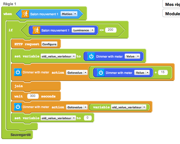

Why this rule doesn't work ?
I want my light to be turned on, or a little increased, when a motion is detected and the luminosity is low.
Here is my rules. It doesn't work. Can someone help me to make it works ?
Capture d’écran...
When you use "Join" , you have to use "Stop" at the end of the rule. (i believe)
You can try to make one rule to go ON and one rule to go OFF.
Ok, now it's working.
Is a malfunctioning rule can block all rules ? I had rules using a deleted http sensor, i deleted them and now it's ok.
Yes, malfunctioning rule can be a problem.
But if you have deleted HTTP sensor from Device manager all rules that used that sensor would be disabled to prevent it causing any problems.
