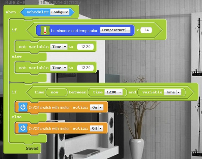

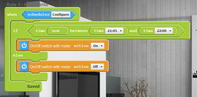

Scheduler is set up every day and weekly repeat. Shorter test rule is valid, but dont work. Another longer is invalid, wants date added somewhere, but scheduler is set up identically. What am I missing this rule thing?

What do you want to do?
Just turn on/off a switch ?
Yes, only simple on/off based on time. These are only test rules, which I use for figure out how this buzzle thing works. My final goal is make sheduled on/off rule, where off-time is depended from temperature measured just before on-time, or during on-state.
Just start with a trigger and the between.
When temp < 14 and between....
Switch = on
When Switch= Any and between..
If Switch=on
Switch Off
else
Switch On

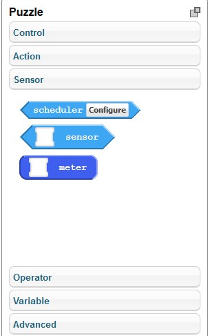

I can't get the if-clause work like I expect. And my Rules creator have at least one missing tile. There is no "Control - condition block to be used with 'Control' devices." tile at all in sensor box.

Yes, i'll look. But, as I wrote previous post, in my rules creator has not anything to test action device state. This kind of blue thing is missing: FILES%2f2014%2f04%2fregel-scheduler-lamp-aan2
Makes some scenarios very difficult. And there is no also any place, where i can choose "any". (refer your post #2)
Now, I suppose, that i have to make 2 different shedule rule. One for switch on, and another to switch off. Looks that way, it is impossible change off-time later, if temp is lower. Or... Is Zipabox occupied for current rule, if i use long "wait" command? Can it do anything else during wait sequence?

Just use the sensor puzzle for Actuators and meter sensors.
Ok, but odd. I tested that again, now sensor puzzle accept switch. Whole yesterday switch was not possible move into sensor puzzle. Offcourse i tried it... Many times.
