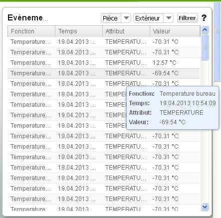

I have two Wintop iDoorSensor I'm using it only for temperature (I know that contact doesn't work with zipabox). But the temperature indication for both are creazy. some time the value come correct ... and after refresh go to extrem values (-77°C,....) . I have try different settings but nothing go better
I attached a copy of event recording for one

after updating the problem still exists see attached picture.
