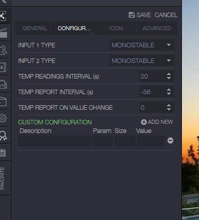

Im getting way too high temperature readings. Is there any way to calibrate or compensate the wrong readings?
Or is there any way to find out if there is something wrong with the sensor or the Fibaro unit?
(See screenshot. This sensor is reading 24.68, while my two other sensors in the same room are reading 22. Which I am quite sure is correct)
You can calibrate the sensors temperature offset. For example here are instructions how to do it for the internal ZT sensor:
https://zipato.infoserv.wiki/integration-notes/calibrate-zipatiles-internal-temperature-sensor/
BR,
Mislav
