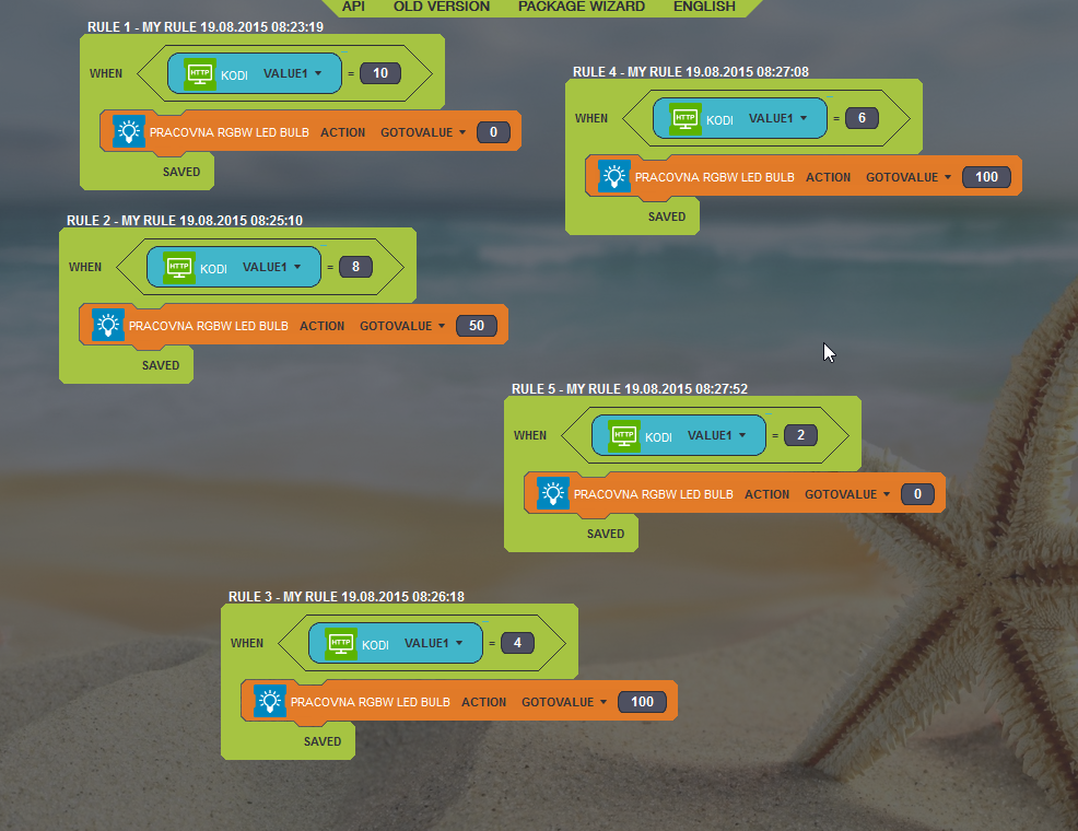

I just tried. After a couple of rial figured out you only need to change the number to 2.15.1. that is it.
Just working through the rest of the guideline...will see what happens.
and it works flawlessly. :) just need to set the right rules...
