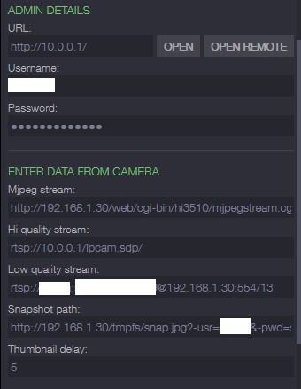

I share to other user my setting:
You definitely have somethings set up incorrectly. For example the MJPEG and snapshot cannot be a rtsp link but a http link. Also it might be possible that you need to find the link that includes the user and password (like in my low quality or snapshot (also in mjpeg but that is at the end hence you cannot see) - so if you load in vlc it will not ask for credentials but load automatically.
