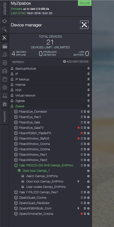

I have two Yale locks succesfully working with the zipabox, you need to buy them with the Z-wave communication module. They report status correctly, I can lock and unlock them and add up to 10 users. I wonder if Zipato is going to support the 255 users Yale claims to be able to handle with the Z-wave module, also to be able to add temporary (scheduled) access, or "one use" pins. I'm still figuring out how to use the events in the rules though...

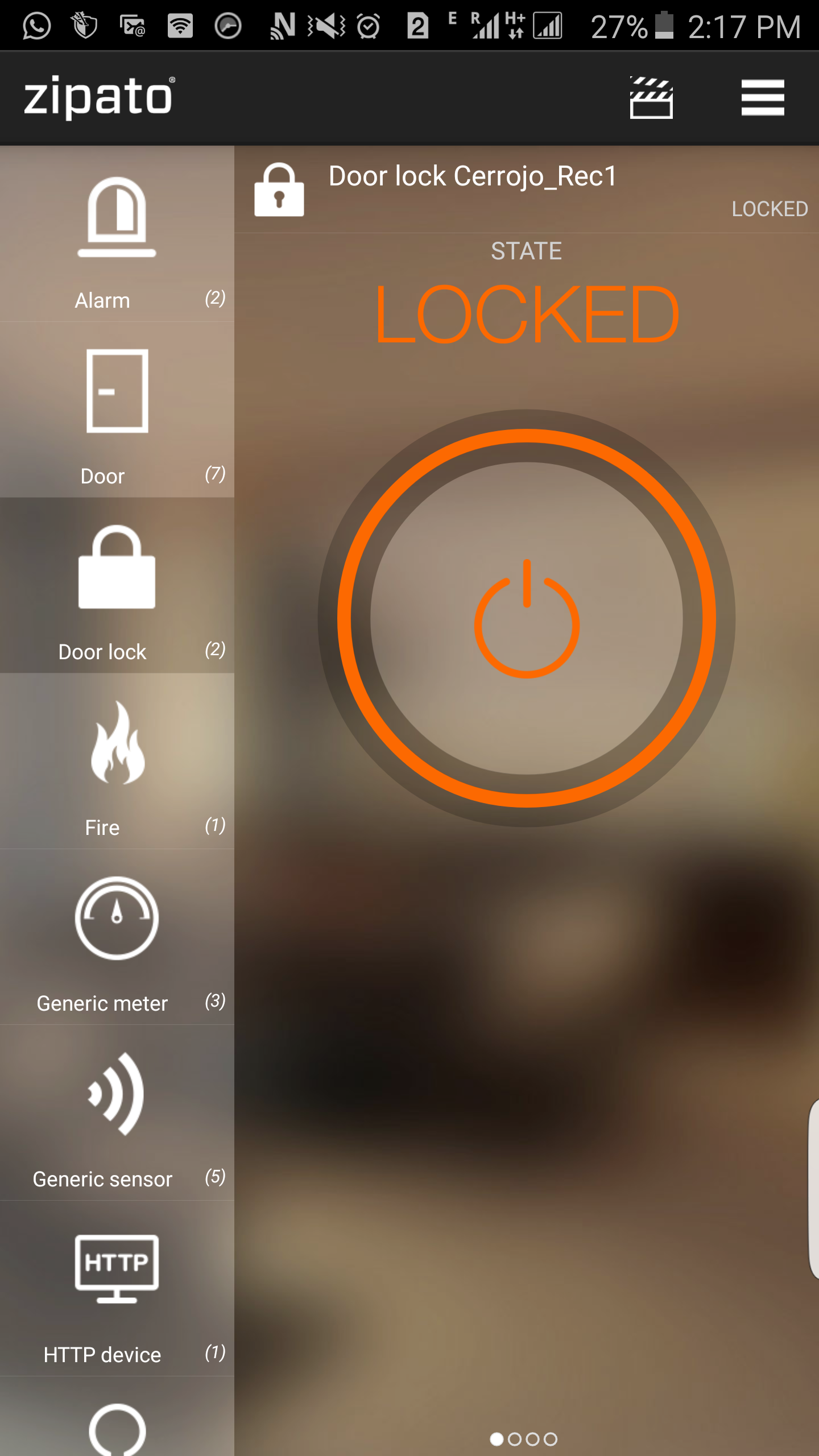

With the official app you cannot configure the Locks, you need the web interface and the zipabox of course. Don't know if the new app (which is in beta stage) will allow to change the configuration of the devices once their added to the controller's network. You can operate them after added to the controller's network, see status and events, also change a few configurations. See attached. My wife has an Iphone and I use an android, they work on both phones.
