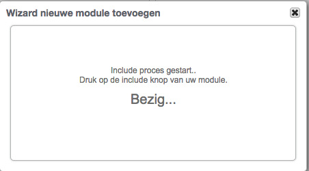

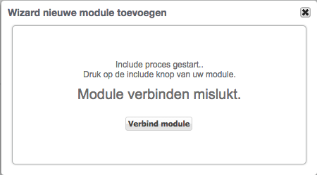

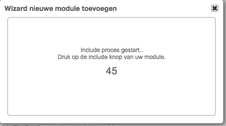

at this moment the P1 module of ZIPATO is not recognized next step is the smart meter...these are the screens i see:
