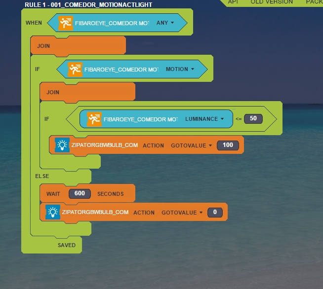

I just started to install my devices at home and playing with the Zipabox, sadly my first rule didn't work without internet connection. I created a motion activated light that only works when the zipabox is connected to the internet. I'm using Fibaro Motion sensor and Zipato RGBW bulb, maybe I'm doing something wrong...

I was online while creating the rule and succesfully synced with the controller. I actually even tried it and all good but, If I unplug the ethernet cable after that, rule doesn't work anymore...
Can you make a screenshot of the Rule?
Sure DerHelle, I really appreciate your help.
rule looks ok. Does the RGBW bulb have constant power?

Yes it does. Weird thing is that the rule works as long as the controller is connected to the internet (green light solid).
Thanks for your help, I think I will have to submit a ticket to zipato support.
