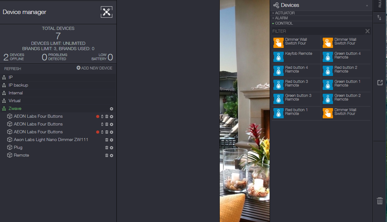

Thank you for that, that solves one problem, however, my 4 button MOTE is still not working properly.
now there are 3 of them, only one online, I tried to remove the other "offline" ones but despite saying its deleted, they are still there. I tried refresh devices, sync controller and sync rules, nothing!
also if you look on the left side of the attached image, the inputs not showing on the right-hand site under control. so there is no way I can make the buttons do anything. what am I missing?
