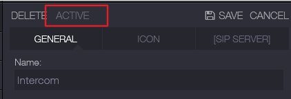

OK, this was quick: in video "How to create SIP SERVER part1", at around 1:10 you can see a small difference. While on the video there is simply "Delete SIP Server" on the top left of the menu (just above the SIP Server name), I had "Delete" and "Activate". With a high res screen you easily miss it. Just pressing "activate" did the trick. (see picture, already activated though).
Without this intermediate step, the server is there, log shows it's OK, but can't be detected or used by the Intercom app.
Everything else works as explained in the videos.

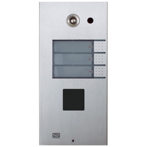

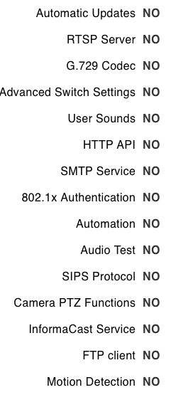

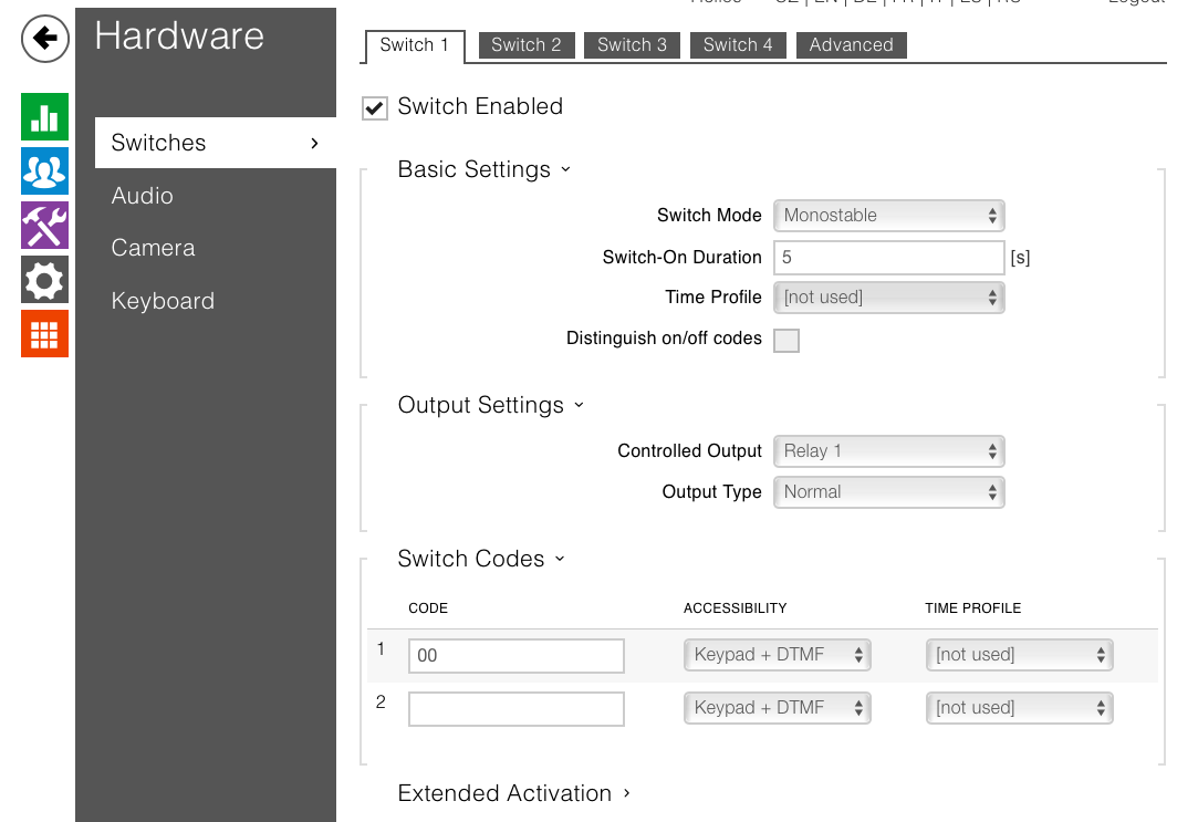

I've just tested SIP Server on Helios IP Vario, but is not working. I've created the SIP Server and is working ...all good , until i press the button on 2N. I will attach a photo of my 2N .
I need licence for SIPS Servers on 2N?
And in settings , I don't have The buttons option.
Can you help me ?
Thank you very much.
