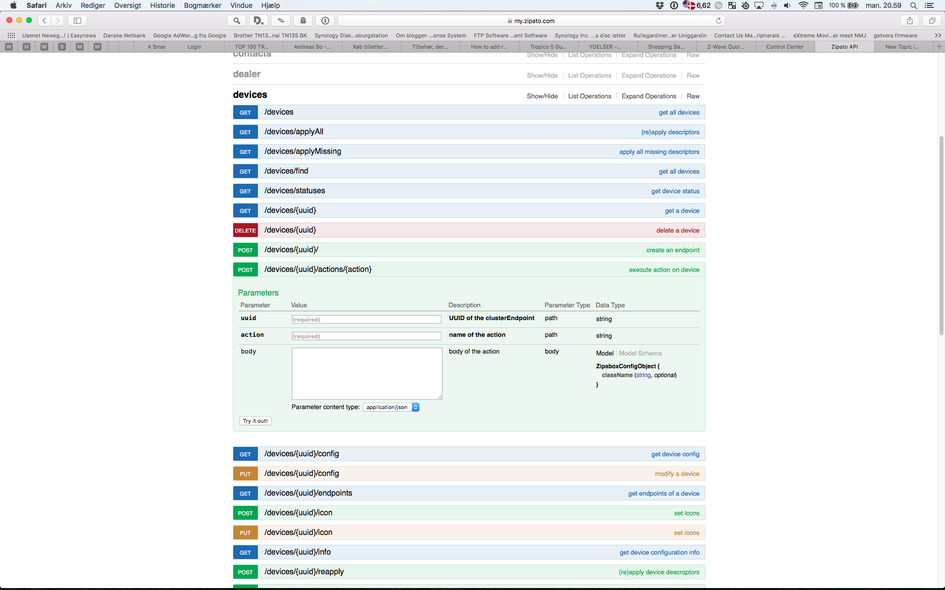

Hi im new on json code and just playing with the zipato api interface.
there is a device action send command where you put in the uiid of the device and send the command to the device.
I just want to send a off command to a on/off switch but off do not work any who know what to type instead?
and do anything needed in the body table also.
Skærmbillede 20...

Although Allan's original request was not the function of the API command in question, we still do not have an answer to how to properly use the "/devices/{uuid}/actions/{action}" API? The API test screen does not say what valid "actions" are and it is a required parameter.
