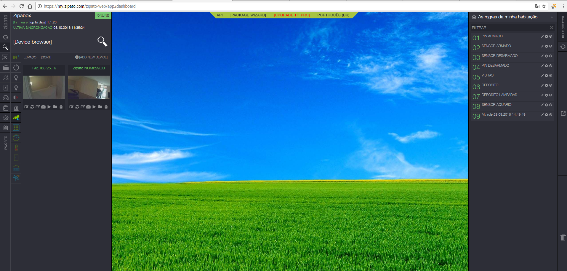

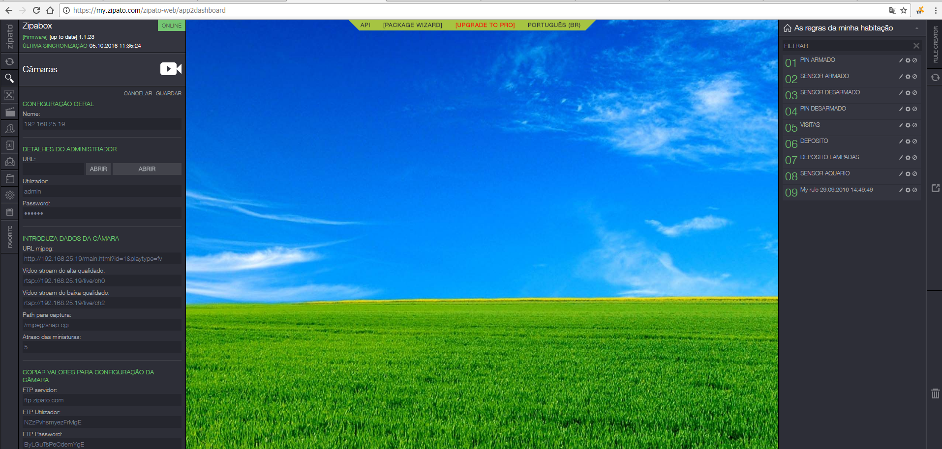

Live broadcast of the camera only works on the same network
I can not see on the Zipato application in the camera online

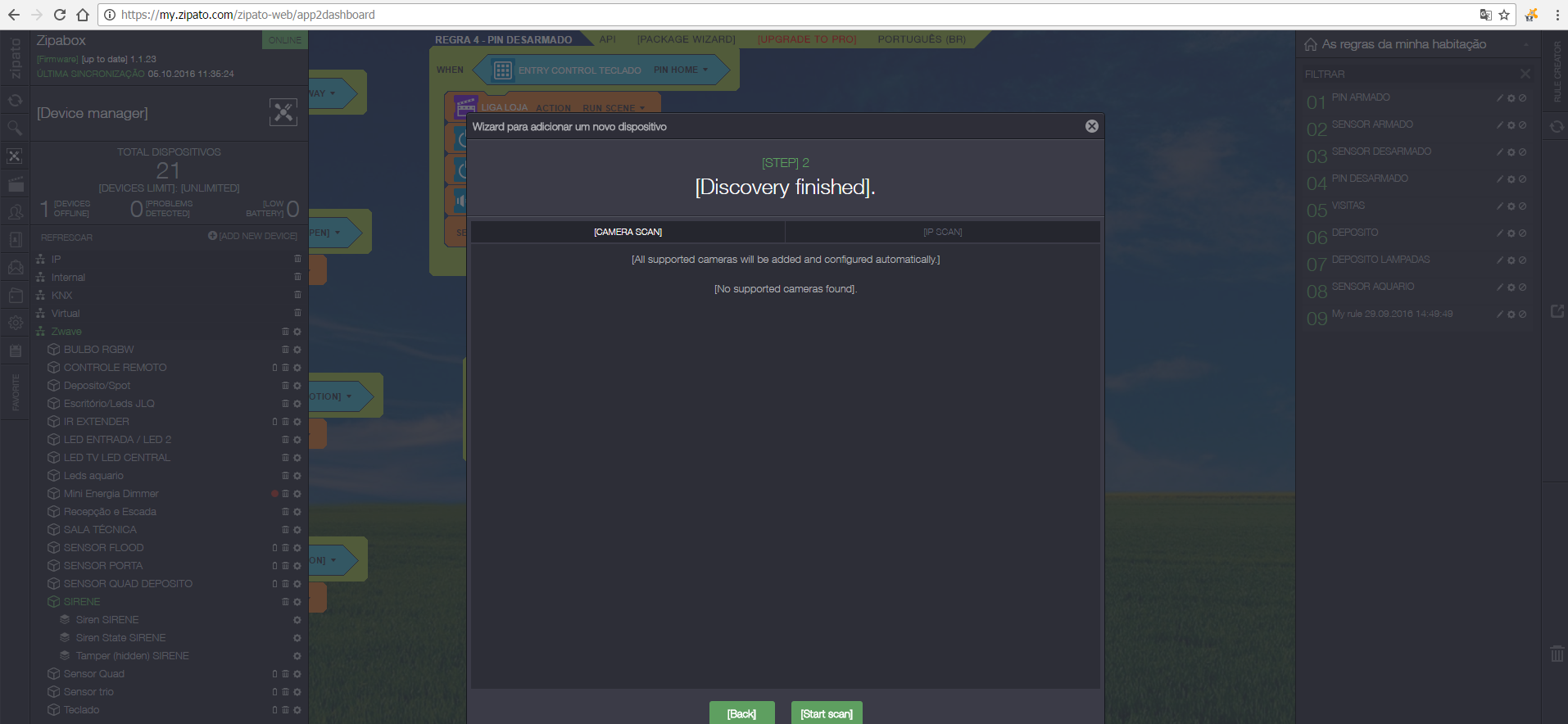

I can not add more than one camera Zipato in Scan in zipabox, why? only for add for IP (even though Zipato cam).

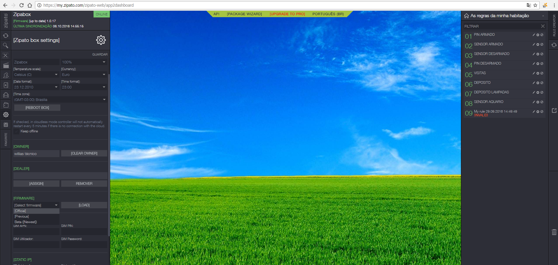

If your cameras are zipato cameras I would suggest you to open a ticket on zipato support. Also I noticed you are using 1.1.23 firmware which in my case was causing issues with Zipato Multi Sensors 4 and Aeotec Multi Sensor 6, not sure if this would be the same case but I had to revert my zipabox to 1.1.17 to get it to work.

how do I revert the firmware 1.1.17??

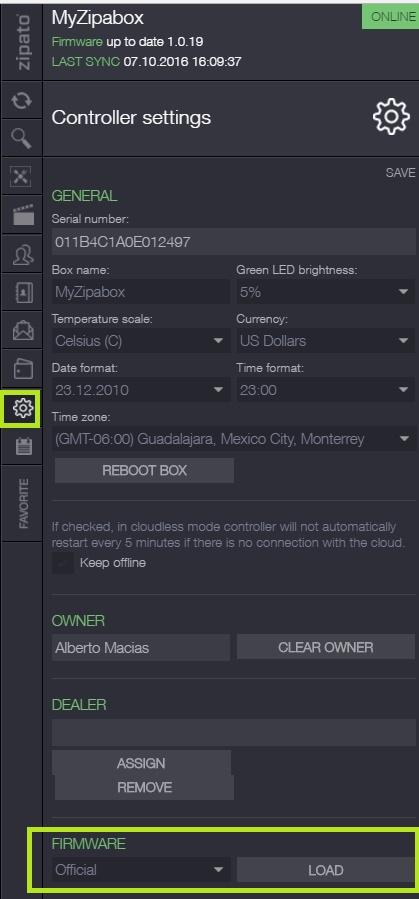

Willias,
See attached screen shot, you have to go to controller settings and load the last official firmware. Please be aware that you are updating the firmware of your controller, please do not disconnect the box while performing this procedure.
