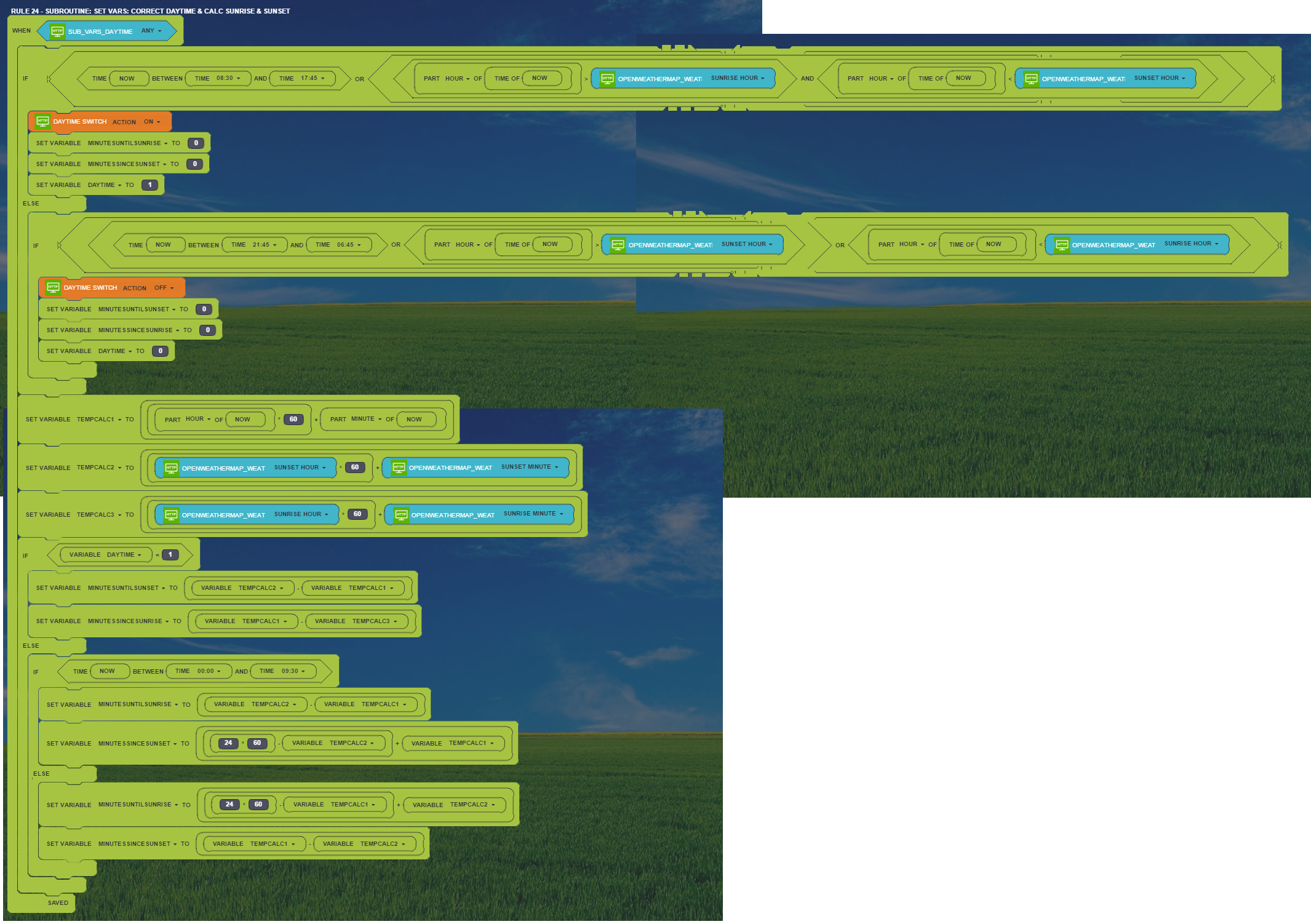

But there are sometimes ways to refresh information periodically. In the case of sunrise and sunset, I use a Google App Script to feed the sunrise and sunset times to the Zipabox every few minutes, and then calculate from there how long it is since sunrise/until sunset, etc. And obviously refresh the daytime state. I give the details here:
https://community.zipato.com/topic/need-a-way-to-store-and-compare-datestimes#comment-26273
I do the same for weather information (I find that the Zipabox weather information is updated very infrequently, sometimes not for hours). The Google App Script in the above link also includes the code for getting weather information from Wunderground and OpenWeatherMap (Wunderground is by far the most reliable).

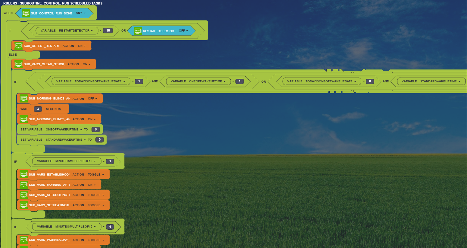

2. A "run scheduled tasks" rule run from the master scheduler. First it detects whether there has been a reboot - this takes advantage of the fact that variables values are reset on reboot. Search for "reboot detector" on this forum. If so, it immediately runs all the rules to recalculate everything. I use a guard variable in my other rules to prevent real-world stuff happening (like blinds or awnings moving) whilst this recalculation is happening. It also has a special "alarm" function which is not important here. If it's not a reboot, then it runs 10-minute rules on multiples of 10 minutes, 15 minute rules on multiples of 15, etc. etc.

Here's a piece of the Run Scheduled Tasks rule and the complete Daytime/Sunrise/Sunset rule (the link I shared above only shows part of it).
Let me know if you want examples of anything specific.
