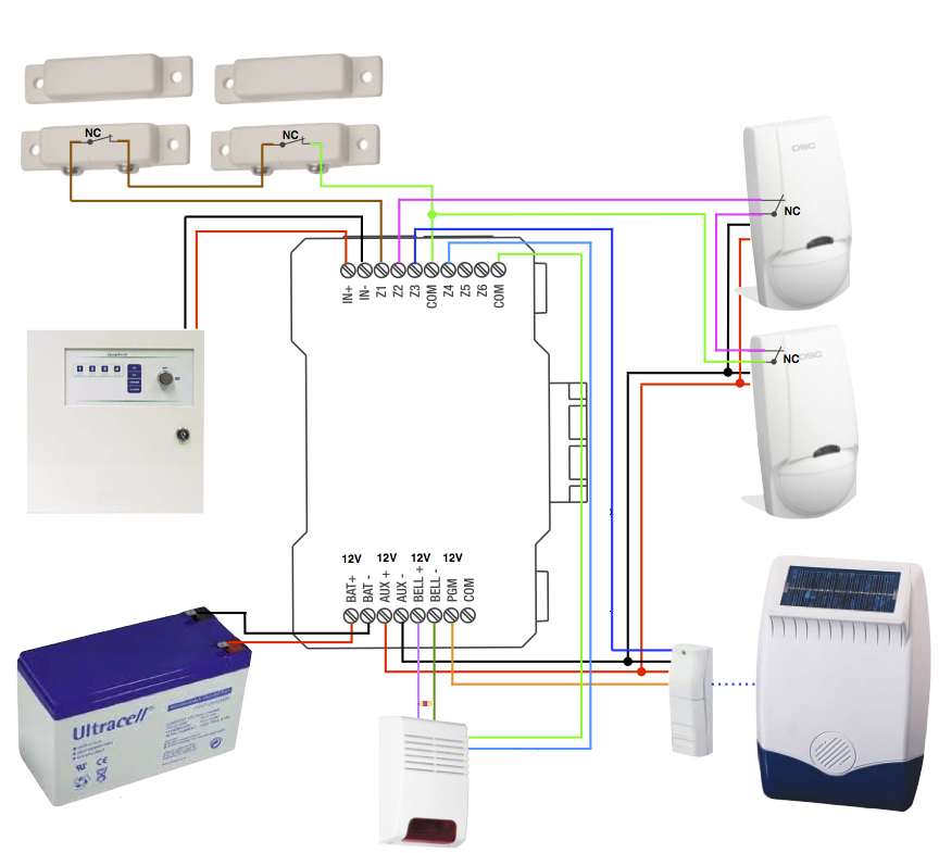

Hellô i’ve just installed the security extension module. Connected a pb battery 12v
Connected a open door detector but never switch to open or close, I connected two wires to the security module (green tocom and blue to z1)however the detector has 4 wires
(Blé green yellow orange ang greenDid I miss something ?
Thanks for your help

Hi Guys,
You can connect to the security expansion module as in the attachment. The following video will also help you or you can email support@zipato.com.

Hi Guys,

I did what is described below however when z1 and com are open , door is in active state and not closed. When z1 and com are connected door is inactive and not open
There seem to be something wrong,
In addition where do I connect tramper cables?

it all depends what kind of detector you are trying to use. Is it NO or NC?
Hello
It is normally open( I declared it in zipabox)
So when not connected door should be seen as closed
And when z1and com are connected door should be seen as opened

Try to swap it around if this helps.
Sorry maybe I was unclear I declared security module zone 1 as a door sensor normally closed and connected two wire to z1 and com respectively.
When I short z1 and com it says inactive when unconnected is says active
But never says close or open ( don’t you think it should when shorted or unshorted?

Active and inactive is correct. The security module doesn't know what sensor you connect. So when it is set to NC and you open the circuit, it will say active.
