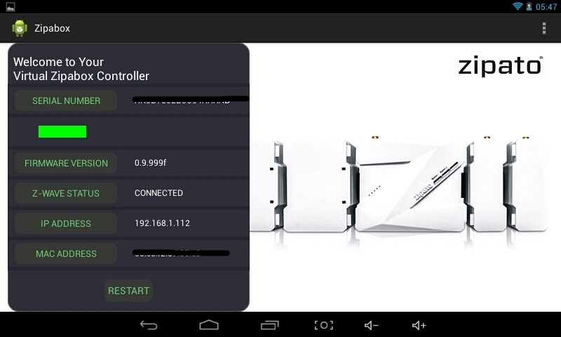

Just got my new Zipato Tablet out of the box, looks fine. Trying to check the usability now. What is the usage for the zipato app included (Zipato Virtual Controller - see pic attached) ? Any proper manual available now ?
2014-09-30 06.4...
Zipato virtual controller is the same Zipato client software which is running in Zipabox. As you have Z-wave module inside, you can basically use this tablet at the same way as Zipabox. However, demo license included will only support connection of up to 3 devices. If you like the software and want to connect more devices, you will need to upgrade your license for connecting more devices.
However, you can always use tablet just as touch panel for controlling Zipabox or any other home controller.

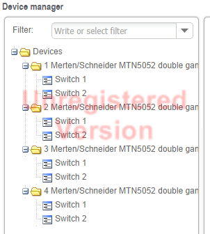

How does the 3 device limit work? I was able to include 4 switches this far - not tested more yet. List attached.
