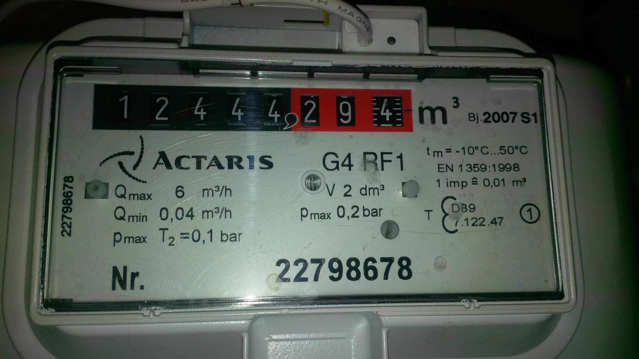

hello,
I don't know if it's linked but with the new firmware I'm able to link and read the data from this reader but I have some problem with the configuration,
I've included the doc from my gas meter and in the setup of the meter in my zipabox I need to enter the value of the pulse factor, meter type (I know is magnetic), pulse count and wake up time any idea how to setup and put thhe right setting for my meter ?
thanks in advance
hello,
thanks in advance
