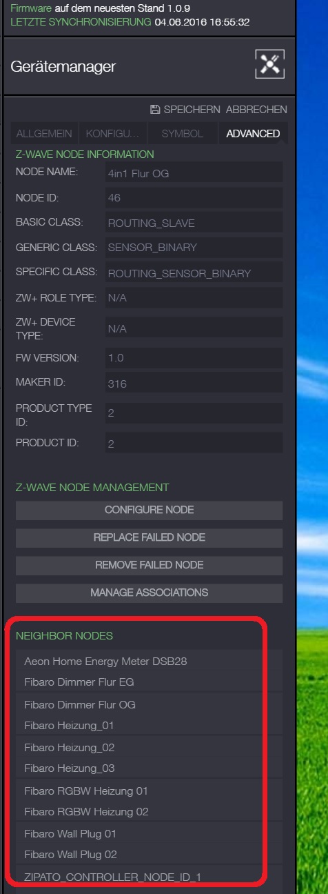

I've also performed a network heal which leads me to a question - Is there some way to "see" the zwave network topology from Zipato controller, either throught the GUI or the API ? It would be nice to have a graphic representation of it, for example habmin for openhab provides something like this.

There are no graphics but you can under a machine check which devices are in range.
