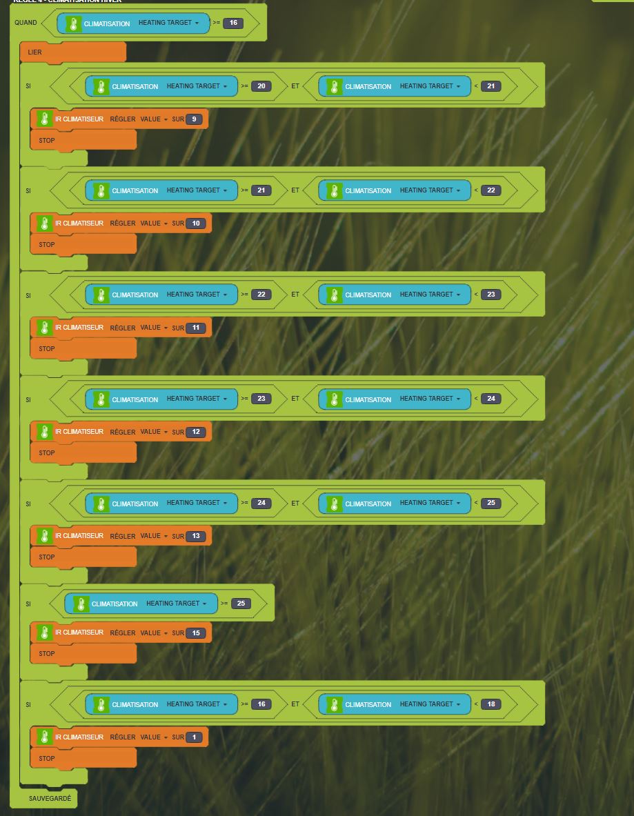

I gave up to find the problem and I simply created a virtual thermostat that works with a ruler that sends IR commands. Attached
Files: Clim.JPG
So then the issue is with the virtual thermostat not with the IR device.
