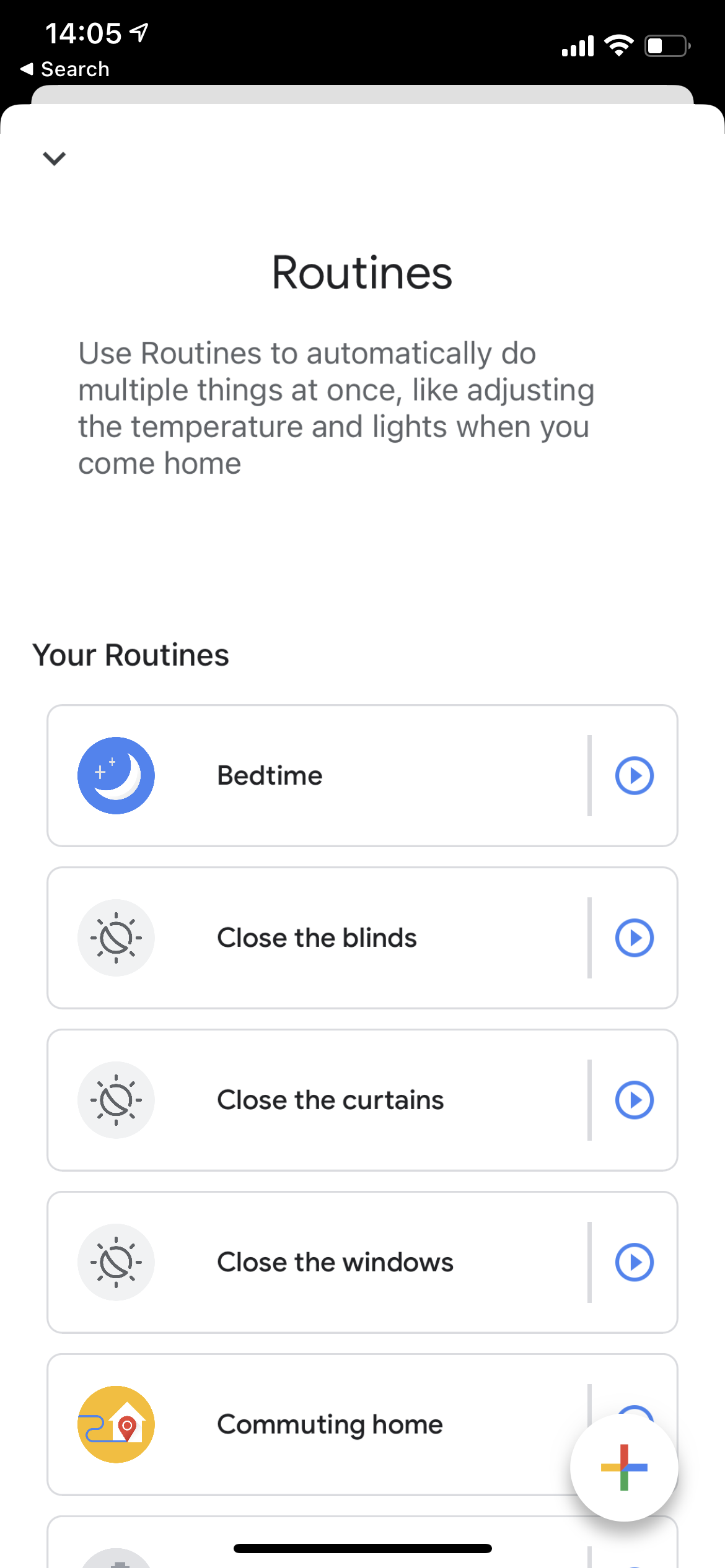

Works like a charm now! I've been able to find the scenes under the "Routines" in the Google Home app. Challenge is that Routines are not available in all countries, I needed to set my phone to United States as location and US English as language in order to set my routines.
But. once the "Routines" functionality showed up (took 8 hours!), I was able to create all of my custom routines, add all Zipato scenes which synced perfectly, and now all is good! The scenes also allow me to control Z-Wave devices which Google Home does not "see" yet. As of now, these are:

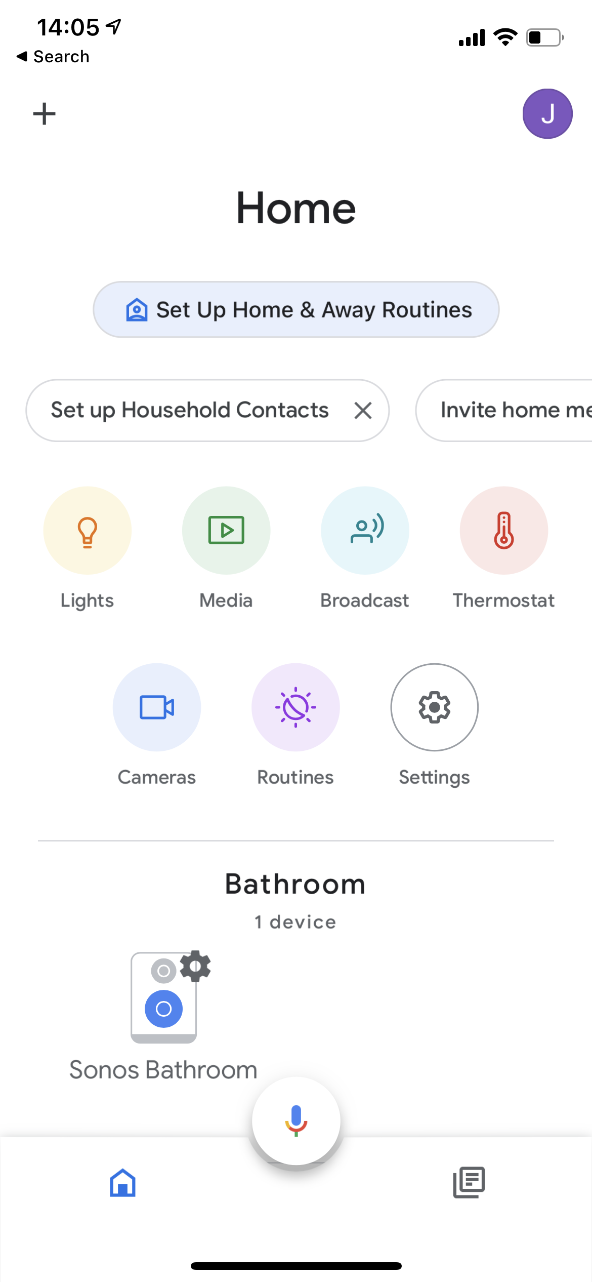

Sure! So, first start by changing the Country and language settings of your phone to US (English). This will make the "Routines" option appear on the main screen, as described here and as visible in image 1 (middle purple icon, between "Cameras" and "Settings"). Be aware: it can take up to 24 hours for the option to appear!

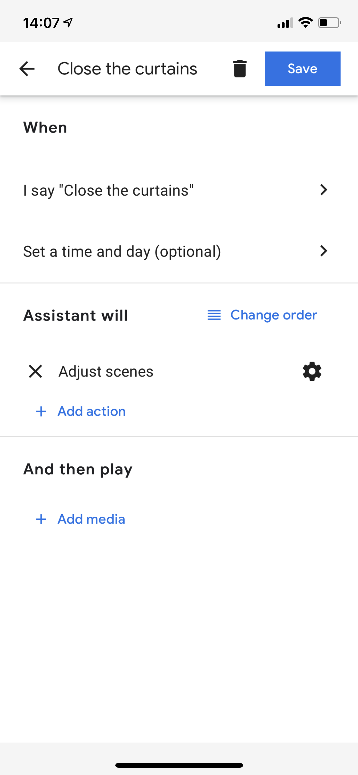

Then, click "Routines", where you will first see all of Google's standard routines (which I personally do not use). If you press the "+" on the bottom left however, you can create a custom routine (image 2).
In the next screen (image 3), you can set the phrase you want to use (in this case: "Close the curtains") and choose other options, plus you can select what Google Assistant needs to do.

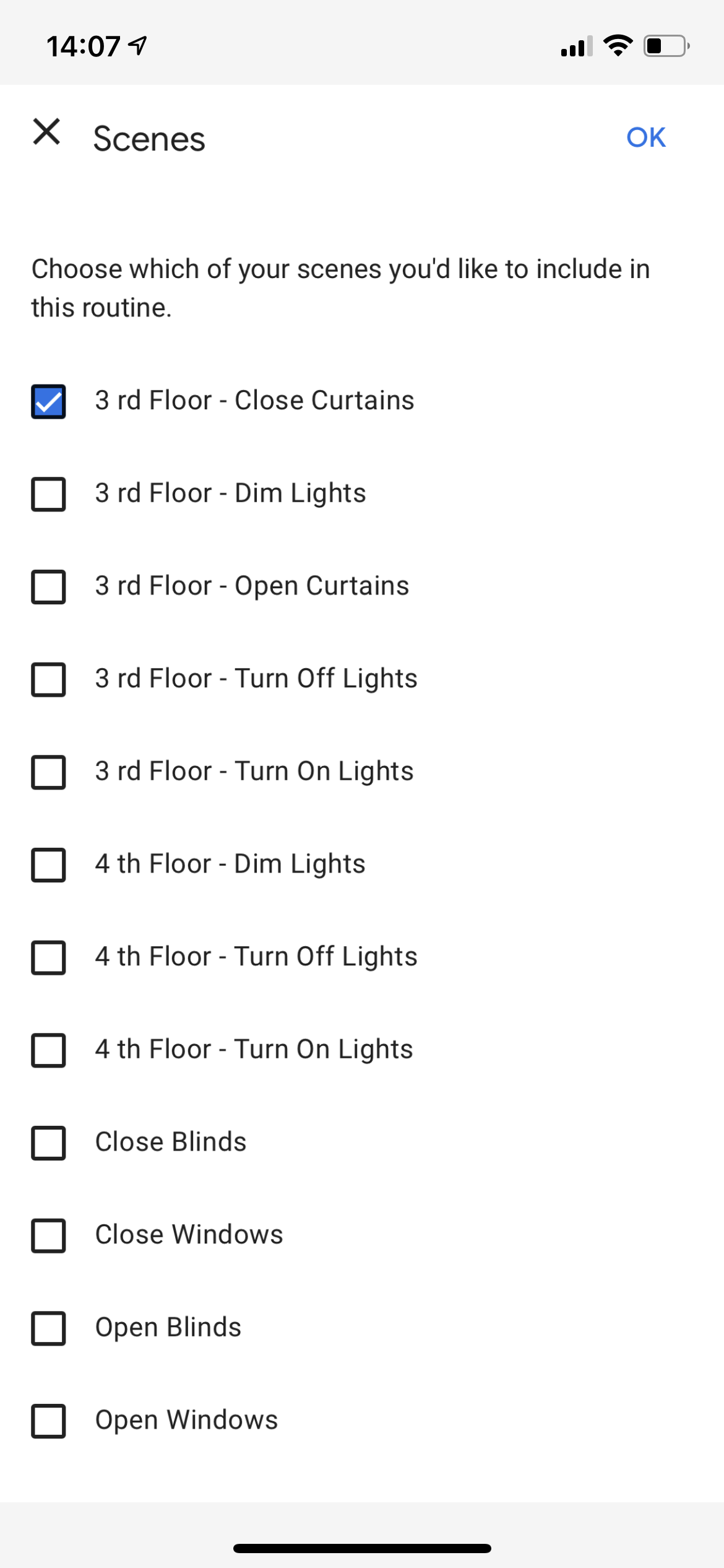

Choose "Add action" here, then choose "Browse popular actions" and check the box next to "Adjust scenes". Click the cogwheel at the right side, and you should see all of your Zipato scenes listed there (image 4). Check the box in front of the scene you want to run, confirm and save the routine - And you're done!
