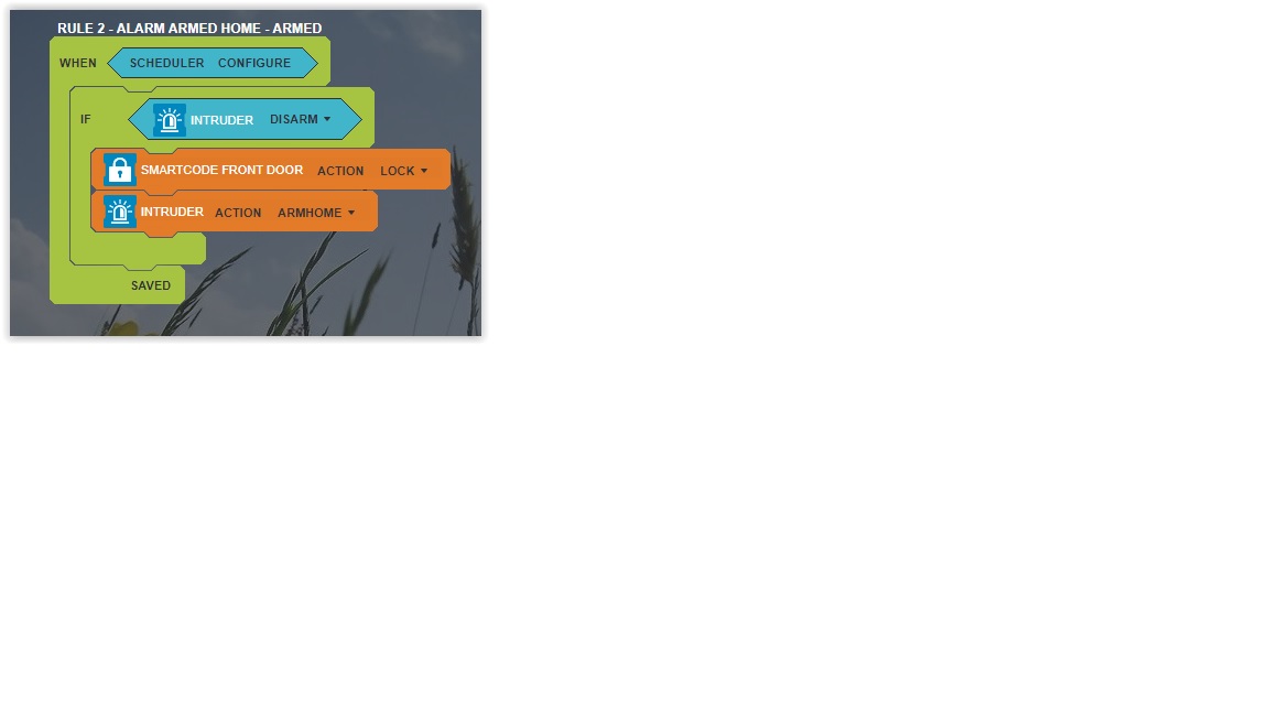

I'm not able to automatically activate the Intruder Alarm partition in Armed Home Mode using a Zipato Control Center Rule

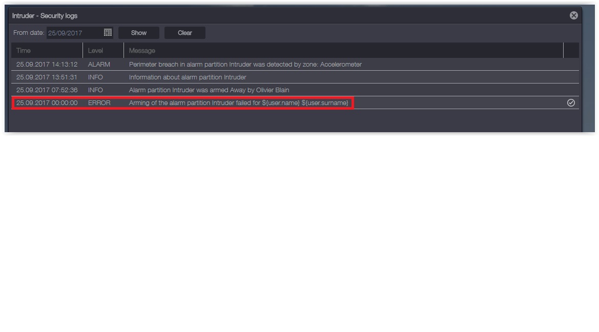

I defined a Rule based on a schedule which is locking the front Door and Activating the Intruder Alarm partition in Arm Home Mode at Midnight. The scheduler is working fine as it is triggering the door to look. However, it seems to be a user or privileges issue with activating the alarm in Arm Home mode. I would have imagine the Master User is used while running commands from Web Control Center defined rules. In this case, I can see from the logs that no user/privilege is passed in the rule command.
See attached the Rule which is really basic and the Security log I get from Intrude Security alarm partition.

Have you enablet quick arm in the alarm options?
3
Hello Attila,
No its not checked. I'll give a try and let you know...
thanks.
