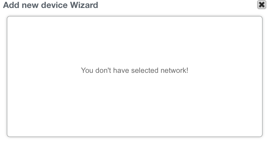

add chacon device doesn't work
i had buy the 433 mhz module and plus in my box, then restart,
when i tries do add a device i get the message, "you don't have select a network"
how can i select network ?
thank for your help
Capture d’écran...
Do you have the 433mhz extension box. The message says you don't have it.
yes i had plus the extension this morning, how can i control if the extension is working ?
i had unplug the 433 mhz module than replug and rester the box, sam a result ....
Maybee the module is out off order
I agree with maarten, it's look like you don't have the 433 extension or it is malfunctioning.
As a last effort: reboot your box (by pressing the reset button). When the box is online: wait at least 5 minutes. The try again adding the chacon device.
If not succesfull then you can also create a ticket at http://support.zipato.com. Then support will look at your box.
After many reboot and try, i'm now able to add and use Chacon device
Tahnks
Tahnks
